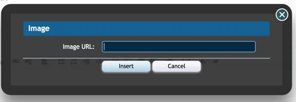

Do you mean this via the editor toolbar?
Also have you tried with other images e.g. ones from other websites rather than just the one on your server?
Can you replicate the issue on here with the image on your server (assuming it's appropriate to use)?
