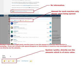

What I liked about [TH] Reactions is that you could see the amount of reaction given for each reaction on the post itself. With XF 2.1 you are only able to see the numbers after pressing it.
I've no idea if it is possible to have an option avaible to enable/disable that with Reactions Plus but I would highly recommend that.
