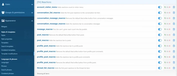

I dont see why the bar is NOT showing up in the postbit if the permissions are set, the add-on is enabled, total reaction received is enabled, Location to display reaction details in postbit is set to either bottom or up, Content handlers is set for posts, Message user info elements in Style properties are set it should show up.
@ALMUSA there has to be something I'm missing. I want to actually use the bar but its not working when I enable it in style properties. I actually don't like counts for dislikes but if I used the bar it would be worth it. I did everything you just said. Are there hidden permissions outside the [TH] Reactions section? I enabled the permissions too and also enabled total reactions for the postbit. I did all that.
Check if template modification is applied
Btw. The bar shows up once you have already gave one reaction at least.
Just saw this. That's what it was. I didn't know you had to receive a reaction first. Wow I appreciate it. I didn't know you had to receive one before you could see it. Thanks.
