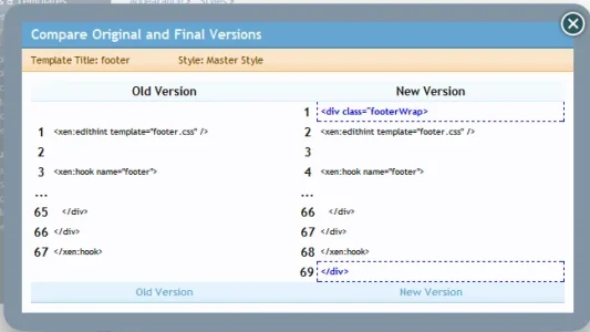

If I wanted to for example wrap the whole footer template with
<div class="footerWrap>
orginal footer template code
</div>
Can I do that with one template edit or would I have to create two, one to add <div class="footerWrap> at the top and another to add </div> at the bottom?

You can use Preg Replace with
search:
#^.*$#s
replace:
$0
</div>

Thanks, I made a mistake in my previous post , I meant what if I wanted to change the top and bottom of the footer template
This at the top:
<xen:hook name="footer">
-- add this new line - <div class="footerwrap">
<div class="footer">
And this at the bottom :
</div>
-- add this new line -- </div>
</xen:hook>
Thanks
The above preg replace wraps the whole footer with hook.
You may wrap inside the hook, but there will be a design issues in this case if some addon will use this hook.
