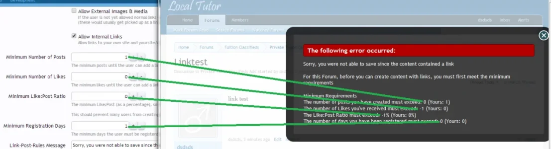

I don't know if this is a bug or whether I need to change the settings but I'm requiring members to be registered for at least 1 day before they can post links:
But this is the message they are presented with when they try to post links on the same day they register:
Rich (BB code):
Sorry, you were not able to save since the content contained a link
For this Forum, before you can create content with links, you must first meet the minimum requirements
Minimum Requirements
The number of posts you have created must exceed: 0 (Yours: 1)
The number of days you have been registered must exceed: 0 (Yours: 0)
Both of the add-on options are set to 1 but are coming up as zero in the message to the end user.
Rich (BB code):

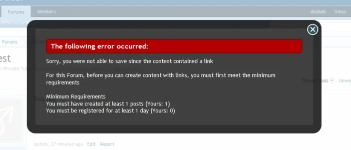

Just tested this exact scenario and have mapped the default message to response to make this clear
This is correct for the default message, since the default message mentions the word "exceed"
Using the new message (in the code above), it would look like this:
Maybe I should use this as the default message (take out the word exceed) to avoid confusion for other users, but this is not a bug... just change the message to make it clear (the values are correct)
I think this will be a clearer message, so I will add it as a default to avoid confusion for other members:
You must have created at least 1 Posts (Yours: 1)
You must have received at least 0 Likes (Yours: 0)
Your Like:post Ratio must be at least: 0% (Yours: 0%)
You must be registered for at least 1 days (Yours 0)

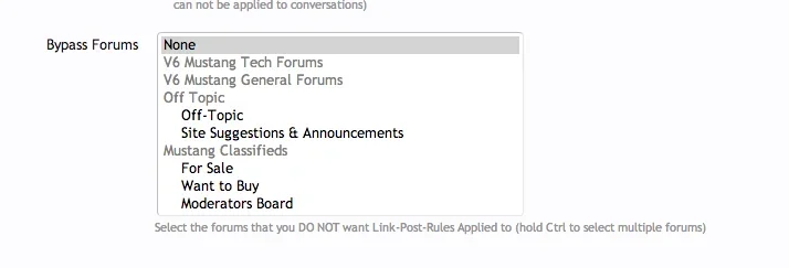

What do you mean it is really off?
You should be able to hold ctrl and select forums to bypass (forums where you don't mind people adding links in their first posts etc)
Can you not select them, or are there some forums missing... you should be able to scroll down, but I don't see the vertical scroll bar in your ACP options (maybe that is the issue)
This is how I get those forums:
        $nodeModel = XenForo_Model::create('XenForo_Model_Node');
        $forumOptions = $nodeModel->getNodeOptionsArray($nodeModel->getAllNodes(), $preparedOption['option_value'], false);
        foreach ($forumOptions as &$forumOpt){
            $forumOpt['disabled'] = ($forumOpt['node_type_id'] == "Forum" ? false : true);
So, I use the core method to get all of the nodes, then I simply look at the nodeType. If it is not a forum, then I simply make it disabled
        $forumOptions[0] = array
            'value' => 0,
            'label' => 'None',
            'selected' => false,
            'depth' => 0,
            'node_type_id' => 0
        sort($forumOptions);
Its all out of order and hard to find forums. They are not arranged as they are on the forum home.
Hmm, I added "sort($forumOptions);" since I thought this was a good idea, clearly not... I'll remove it and re-up this version
You can see all of you forums in that list though, can't you? (there is a vertical scroll bar, or is that missing)
