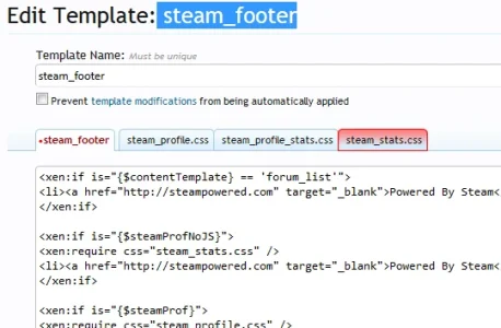

Now I'm having a problem. Is there any sort of protection implemented by your add-on against modifications of the steam_footer template? Whenever I try to edit the template the system marks it as modified (with the red dot before the template name on the respective tab) even when I haven't still put the focus on the text box to make the edits I want.
Btw I'm just trying to get rid of the link on my forum_list... I tried and any change to that template makes the add-on to stop working: no Steam in postbits nor profiles but as soon as I revert the changes the Steam information is available again on both postbits and profiles.

There is no such anti-template tampering feature in this addon. If you remove the Powered By Steam link back, you do so at your own risk. It's part of their API terms and conditions that you have it on your site. Editing a template incorrectly can also cause the addon to break.
