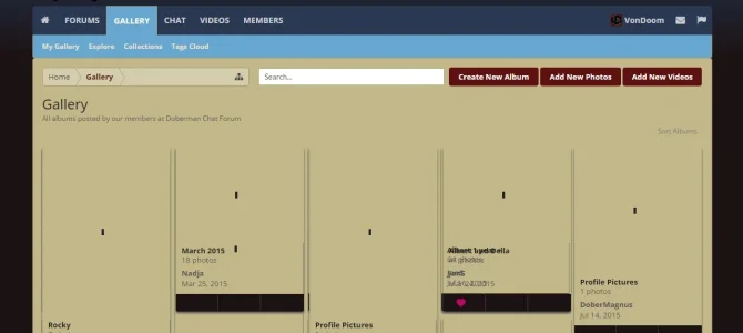

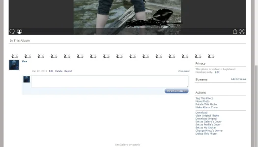

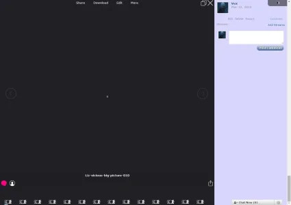

Seem missing something. Gonna fix it soon.@sonnb I found a major bug in the new version. If I view an album/picture/video via the navbar link(s) it produces the following (see screenshots). And also I have trouble going to full screen mode (the site will hang). The loading icons also hang and never show the thumbs. Thanks for your hard work!
- Fix issue not able to load the thumbnails in Photo view and Video view due to missing js file in template.

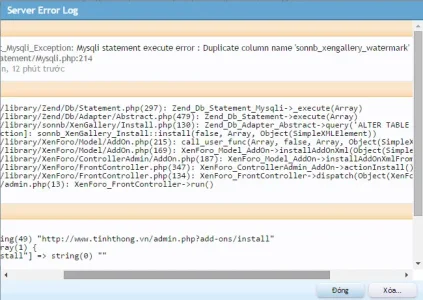

I seem that you have the field sonnb_xengallery_watermark before you install the addon. I suggest you to uninstall and install it again.Dear @sonnb ,
I've just bought sonnb - XenGallery (XenForo Gallery) today and installed the version 2.4.1 Fix A in my forum but got the same issue of loading image. Then I checked the server log file, I saw this below error. Please help me!
I tried to uninstall and install it two times but got the same resultI seem that you have the field sonnb_xengallery_watermark before you install the addon. I suggest you to uninstall and install it again.
Did you try manually removing all gallery database tables via phpmyadmin and trying a completely "fresh" install?I tried to uninstall and install it two times but got the same result![]()
Because above query was failed to run. It also includes the one you have just run. I will improve the installation script and will send you the fixed one via conversation.Thanks for your reply. I uninstalled the add-on and checked via phpmyadmin to see if there's anyu son* table existing. No table remained, then I installed again the ad-on but the result is still the same. I still saw the error in the log file. How to fix it?
However, when I checked GALLERY, all images were loaded properly.
One more issue I found out is that, when I enabled this add-on, people could not register in my forum. So I had to run this command to solve it issue
"ALTER TABLE xf_user_option ADD COLUMN xengallery blob NULL;"

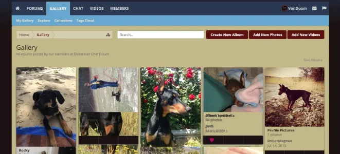

It could help if you can send me your URL. I have a development instance of UI.X running and I see no issue with it. Please make sure you have no out-of-date templates.Im having a problem with the latest version (XG 2.5.1 With XF 3.5 B3) that wont load thumbnails.. enabling the interlaced option the thumbs load fine however some weird overlapping happens when i scroll up or down producing some unfavorable effects..
Interlaced Option Disabled...
Interlaced Option Enabled
EDIT:
Turns out this might be a problem with UI.X
