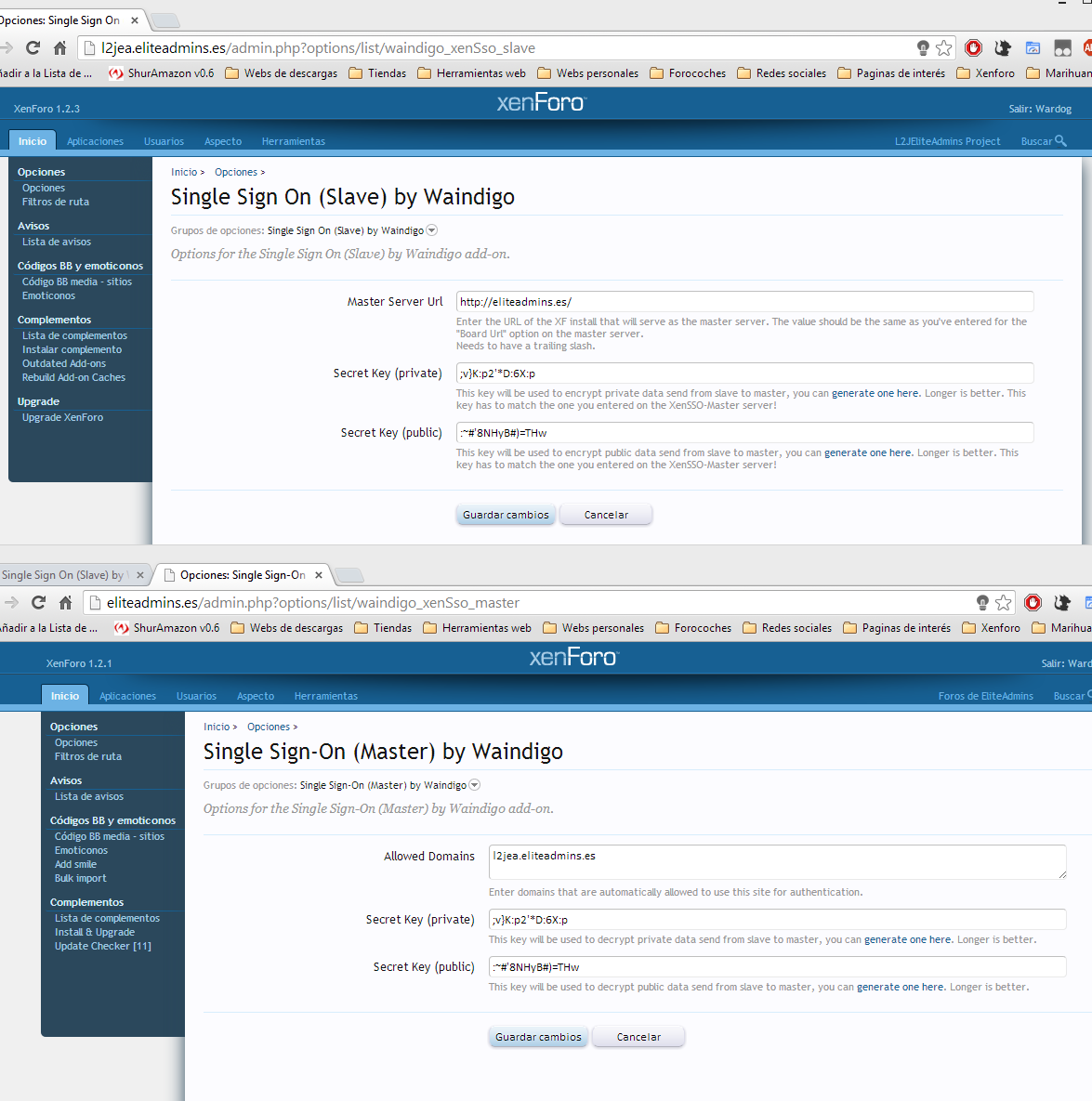

Check your configuration. If you still get errors, please post screenshots.
its ok?
Yer, looks good. Does it match the board URL on your general options screen?

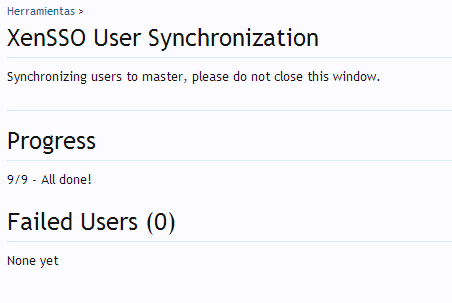

Also, have you run the sync on the slave server?
Admin CP -> Tools -> XenSSO -> Synchronise Users
