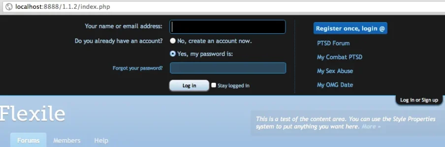

Hopefully the "sister sites" will let users know (in the Login area) they can use the login and password from the first site.
Made a quick version to achieve this today... so it can be done. No, I don't plan on releasing a supported add-on to do this, but I will list it in the SSO thread when Nathan releases his mod, as an unsupported addition for those to enable the eAuth bar when FB or such is not enabled....
The below is a basic list version, though you could do it anyway you wanted... phrase it, image, etc.

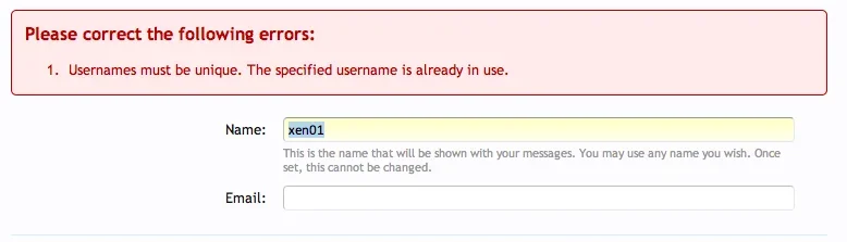

What if someone tries to register at a second site with the login name of someone else that already exists the first site?
Then they get an error upon registration like the below:

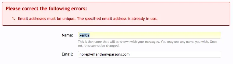

Adding another good example, I register on a slave as xen01 with email address. That also registers at the master account.
Now I try and register a different username, xen02 at another slave, using the same email address as I used with xen01, and the same resulting error:
I will say, this has been thoroughly tested using default Xenforo registration fields.
