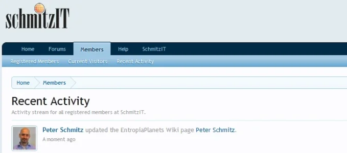

Version 2.0 will stream updates made in the Wiki into the "Recent Activity" stream, as can be seen in the screenshot:

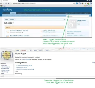

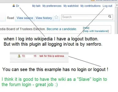

Digital Doctor
There appears to be some relatively robust login and logout synchronization.
I was able to log into the forums and when I went to the wiki ... I was logged in there as well.
As well, when I logged out of the forums .... I was logged out of the wiki.
Nice !

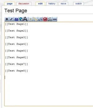

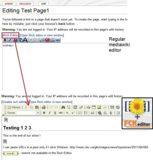

Digital Doctor
Could you please specify what you mean? I'm not really sure? We use the default WYSIWYG editor that comes with MediaWiki.
Here is the editor in use on your site. It isn't WYSIWYG. It's wiki markup.
Are you talking about the better looking editor that was released as an add-on?[/quote]
http://www.mediawiki.org/wiki/WYSIWYG_editor
I think FCKeditor is the one that is most promising.
Site: http://mediawiki.fckeditor.net/
Demo / Sandbox - http://mediawiki.fckeditor.net/index.php/Sandbox
You can click on one of these Test Pages - http://mediawiki.fckeditor.net/index.php/Test_Page and edit away !
default.mediawiki.editor.isnt.WYSIWYG.it.is.codes.jpgFCKeditor.mediawiki.rich.text.editor.jpg
But I couldn't even add a wiki link from within the Rich Text editor.
