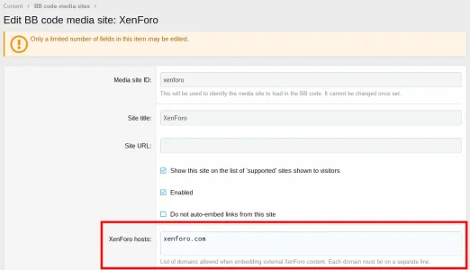

JoshyPHP updated s9e Media Sites with a new update entry:
Added support for embedding external XenForo 2.3 content
XenForo 2.3 adds a new feature allowing public content to be embedded in any page. This update adds support for your forum to embed the publicly accessible content of any XenForo 2.3+ forum that has enabled this feature.
How to configure: go to your admin panel, go either to this add-on's options or to the XenForo entry in the BB code media sites menu, then add the hostname of the XenForo 2.3+ forum you want to embed from. Make sure that the target website runs XenForo 2.3, which at this time is a very short list.
heh. i think 2.3 is only installed here for now. installed it. tested it on my board. and it works as intended. some links did not convert into embed code right away and had to be reposted. also looks like non embeddable links do not result in a fake embed (like node links) which is nice though might need some more testing. thanks for this. i never thought i would need this but it's good to have!

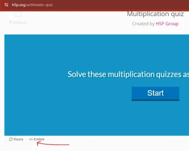

I don't know what H5P is, as far as I can tell it's not on the list of supported sites. If you're trying to upload your own videos, that's not in the scope of this add-on. Check out XenForo Media Gallery, see if that's what you're looking for.
h5p.org
Yeah, no, that's not a website that provides content to be embedded. This add-on only works with sites like YouTube, etc...
I'm sorry but I can't communicate like this; It's just taking too much of my time. If you want to sponsor the addition of a website, you can send me a direct message with your budget and I'll look into it. Otherwise, I suggest asking in the support forum if someone can help you create a custom media site for your forums. That's a default XenForo feature that does not require this add-on.
