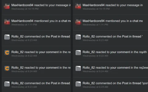

I have found a mini bug:
When someone reacts to a comment in a report, the alert does not show the avatar of the responder, but the avatar of the commenter.
In the following screenshot you can see the correct avatar of the user "Rollo_82" in the first alert.
In the second alert, his name is shown and linked, but my avatar is shown and my profile is linked.

The database entries look normal. user_id and username are correct.
The wrong avatar also appears with the default template.
But I could notice that the correct avatar is displayed when I disable the template modification "svReportImprov_alert_macros".
Left enabled, right disabled:
Might it have something to do with $alert.Content.ViewableUser?
