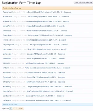

Just a brief update and ranting and raving of Chris and this add-on. I've had my board for not yet 14 months and have not had any spammer issues until about 2 months ago. It got so bad that I had to set approval to "manual approval" status and in a 2 day period it would be normal to have to 'reject' 400-500 new users. Insane! Because I had to manually click 'reject' and then uncheck the 'send email' button, it would take a good hour to two sometimes to double check each user (and I would also manually check their IP addresses and individually ban them. Insanity - I'm up to 200 cups of coffee by now... (just kidding).
Chris' add-on has made it possible where bots are caught and I have set the add-on so that it redirects them to a spam reporting agency website. haha. I'm hoping they're gonna get pretty tired of getting redirected to others.
In less than 15 minutes this add-on caught 9 spammers! You can do the math, that's more than spammer for every 2 minutes.
And Chris even went above and beyond and helped me install it. What a great guy - and a great add-on! Thank you!
When I got up this morning I had over 220 spammers that were caught with Chris' add-on. I decided to put the "manual approval" back on last night and am glad I did, there were about 10 who slipped through the cracks. Awesome job, Chris!
