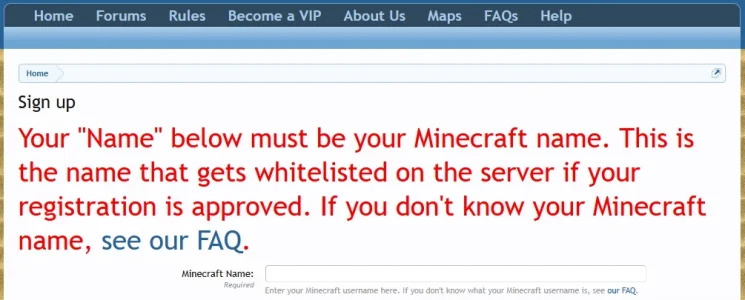

I added a message to our registration form (seen in red on the attached screenshot), but I have looked everywhere I can think of in the admin area and cannot find this message any more. Does anyone know where you would go to add/edit a message on the registration form as I have done here? It's not in the register_form template, which is where I thought it would be...
I don't think it's from an add-on either. I'm stumped and could use some help, please.

I found it. Apparently I modified the Default Style, not the Master Style. When you do a search for register_form, it takes you to the Master Style. That's why I wasn't finding it.
I had to go to Appearance -> Customized Components and then saw register_form in the list of customized templates.
Thanks.
Be careful, you are in "Development Mode" if you are able to edit Master style templates. Unless you're creating an add-on, editing cron jobs, or adding/editing template modifications, you should not be using "Development Mode". For most instances where you want to make a change to a template you should be editing the default style - like it appears you did correctly originally.
