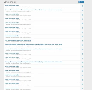

  • CredisException: read error on connection to tcp://127.0.0.1:6379
  • src/addons/SV/RedisCache/Credis/Client.php:1326
  • Generated by: Unknown account
  • Jun 7, 2022 at 11:42 AM
Stack trace​
#0 src/addons/SV/RedisCache/Redis.php(409): Credis_Client->__call('mget', Array)
#1 src/addons/SV/RedisCache/Redis.php(49): SV\RedisCache\Redis->SV\RedisCache\{closure}()
#2 src/addons/SV/RedisCache/Redis.php(436): SV\RedisCache\Redis->redisQueryForStat('gets', Object(Closure))
#3 src/addons/SV/RedisCache/CacheProvider.php(63): SV\RedisCache\Redis->doFetchMultiple(Array)
#4 src/XF/DataRegistry.php(115): SV\RedisCache\CacheProvider->fetchMultiple(Array)
#5 src/XF/DataRegistry.php(83): XF\DataRegistry->readFromCache(Array, Array)
#6 src/XF/DataRegistry.php(228): XF\DataRegistry->get(Array)
#7 src/XF/App.php(1797): XF\DataRegistry->offsetGet('dbtCreditsCurre...')
#8 src/XF/Container.php(31): XF\App->XF\{closure}(Object(XF\Container))
#9 src/addons/DBTech/Credits/XF/Entity/User.php(179): XF\Container->offsetGet('dbtechCredits.c...')
#10 src/addons/SV/UserEssentials/XF/Entity/User.php(401): DBTech\Credits\XF\Entity\User::getStructure(Object(XF\Mvc\Entity\Structure))
#11 src/addons/SV/ConversationEssentials/XF/Entity/User.php(499): SV\UserEssentials\XF\Entity\User::getStructure(Object(XF\Mvc\Entity\Structure))
#12 src/addons/SV/SignupAbuseBlocking/XF/Entity/User.php(390): SV\ConversationEssentials\XF\Entity\User::getStructure(Object(XF\Mvc\Entity\Structure))
#13 src/XF/Mvc/Entity/Manager.php(72): SV\SignupAbuseBlocking\XF\Entity\User::getStructure(Object(XF\Mvc\Entity\Structure))
#14 src/XF/Repository/User.php(86): XF\Mvc\Entity\Manager->getEntityStructure('XF:User')
#15 src/XF/Repository/User.php(32): XF\Repository\User->getGuestUser()
#16 src/XF.php(586): XF\Repository\User->getVisitor(0)
#17 src/XF/PageCache.php(154): XF::visitor()
#18 src/XF/Pub/App.php(142): XF\PageCache->getCachedPage(Object(XF\Pub\App))
#19 src/XF/App.php(2348): XF\Pub\App->start(true)
#20 src/XF.php(524): XF\App->run()
#21 index.php(20): XF::runApp('XF\\Pub\\App')
#22 {main}
Previous RedisException: read error on connection to tcp://127.0.0.1:6379 - src/addons/SV/RedisCache/Credis/Client.php:1308
#0 src/addons/SV/RedisCache/Credis/Client.php(1308): Redis->mget(Array)
#1 src/addons/SV/RedisCache/Redis.php(409): Credis_Client->__call('mget', Array)
#2 src/addons/SV/RedisCache/Redis.php(49): SV\RedisCache\Redis->SV\RedisCache\{closure}()
#3 src/addons/SV/RedisCache/Redis.php(436): SV\RedisCache\Redis->redisQueryForStat('gets', Object(Closure))
#4 src/addons/SV/RedisCache/CacheProvider.php(63): SV\RedisCache\Redis->doFetchMultiple(Array)
#5 src/XF/DataRegistry.php(115): SV\RedisCache\CacheProvider->fetchMultiple(Array)
#6 src/XF/DataRegistry.php(83): XF\DataRegistry->readFromCache(Array, Array)
#7 src/XF/DataRegistry.php(228): XF\DataRegistry->get(Array)
#8 src/XF/App.php(1797): XF\DataRegistry->offsetGet('dbtCreditsCurre...')
#9 src/XF/Container.php(31): XF\App->XF\{closure}(Object(XF\Container))
#10 src/addons/DBTech/Credits/XF/Entity/User.php(179): XF\Container->offsetGet('dbtechCredits.c...')
#11 src/addons/SV/UserEssentials/XF/Entity/User.php(401): DBTech\Credits\XF\Entity\User::getStructure(Object(XF\Mvc\Entity\Structure))
#12 src/addons/SV/ConversationEssentials/XF/Entity/User.php(499): SV\UserEssentials\XF\Entity\User::getStructure(Object(XF\Mvc\Entity\Structure))
#13 src/addons/SV/SignupAbuseBlocking/XF/Entity/User.php(390): SV\ConversationEssentials\XF\Entity\User::getStructure(Object(XF\Mvc\Entity\Structure))
#14 src/XF/Mvc/Entity/Manager.php(72): SV\SignupAbuseBlocking\XF\Entity\User::getStructure(Object(XF\Mvc\Entity\Structure))
#15 src/XF/Repository/User.php(86): XF\Mvc\Entity\Manager->getEntityStructure('XF:User')
#16 src/XF/Repository/User.php(32): XF\Repository\User->getGuestUser()
#17 src/XF.php(586): XF\Repository\User->getVisitor(0)
#18 src/XF/PageCache.php(154): XF::visitor()
#19 src/XF/Pub/App.php(142): XF\PageCache->getCachedPage(Object(XF\Pub\App))
#20 src/XF/App.php(2348): XF\Pub\App->start(true)
#21 src/XF.php(524): XF\App->run()
#22 index.php(20): XF::runApp('XF\\Pub\\App')
#23 {main}
I frequently get this error every hour or so randomly
I don't recommend configuring redis to save to disk. Check this add-on's FAQ for notes on what you need to change.
Server configuration is well outside this add-on's support
