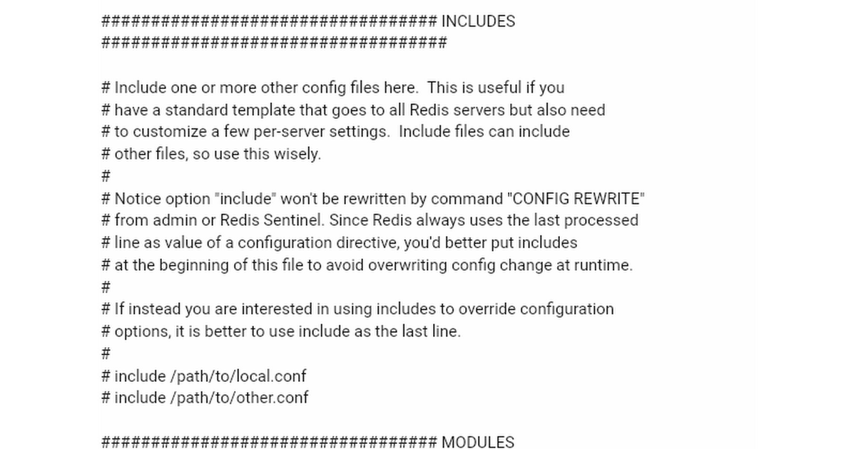

Sorry but I'm not sure, is that redis config file? I found the file in /etc/redis/redis.conf
Here is mine config redis file, I leave it default, seems like "save" statements is already has "#", could you take a look please
I'm currently in something of a time-crunch with existing commitments and don't have time to take on additional sysadmin support work. The hosting sub-forum should be able to help with with this.
# It is also possible to remove all the previously configured save
# points by adding a save directive with a single empty string argument
# like in the following example:
save ""
save ""
Thank you both, after I searched more on google it turns out I just need to restart redis and it didn't happen again

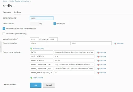

Hi,
I just move to a new server. I get the bellow Apache error. I am running Ubuntu 20.04 with a Plesk deployment (last version).
I don't understand fro the log, what the actual problem is. Would be happy if someone can help me to solve the issue.
My XenForo Redis Config:
Bash:
#redis cache
$config['cache']['sessions'] = true;
$config['cache']['enabled'] = true;
$config['cache']['provider'] = 'SV\RedisCache\Redis';
$config['cache']['config'] = [
'server' => '127.0.0.1',
'port' => 6379,
Here are the Redis settings on Plesk Docker container.
XenForo Error Log.
Bash:
2023-05-24 16:22:48    Error    XXX.XXX.XXX.XXX        AH01071: Got error 'PHP message: PHP Fatal error: Uncaught RedisException: READONLY You can't write against a read only replica. in /var/www/vhosts/MYDOMAIN.com/httpdocs/src/addons/SV/RedisCache/Credis/Client.php:1280\nStack trace:\n#0 /var/www/vhosts/MYDOMAIN.com/httpdocs/src/addons/SV/RedisCache/Credis/Client.php(1280): Redis->set('xf_data_codeEve...', 'gz:\\x1F\\x8Bx\\x01\\xBD[\\xDDr\\x9B\\xC8\\x12~...', 3600)\n#1 /var/www/vhosts/MYDOMAIN.com/httpdocs/src/addons/SV/RedisCache/Redis.php(598): Credis_Client->__call('set', Array)\n#2 /var/www/vhosts/MYDOMAIN.com/httpdocs/src/addons/SV/RedisCache/Redis.php(49): SV\\RedisCache\\Redis->SV\\RedisCache\\{closure}()\n#3 /var/www/vhosts/MYDOMAIN.com/httpdocs/src/addons/SV/RedisCache/Redis.php(606): SV\\RedisCache\\Redis->redisQueryForStat('sets', Object(Closure))\n#4 /var/www/vhosts/MYDOMAIN.com/httpdocs/src/addons/SV/RedisCache/CacheProvider.php(92): SV\\RedisCache\\Redis->doSave('xf_data_codeEve...', Array, 3600)\n#5 /var/www/vhosts/MYDOMAIN.com/httpdocs/src/XF/DataRegistry.php(18...', referer: https://www.google.com/                Apache error
2023-05-24 16:22:48    Error    XXX.XXX.XXX.XXX        AH01071: Got error 'PHP message: PHP Fatal error: Uncaught RedisException: READONLY You can't write against a read only replica. in /var/www/vhosts/MYDOMAIN.com/httpdocs/src/addons/SV/RedisCache/Credis/Client.php:1280\nStack trace:\n#0 /var/www/vhosts/MYDOMAIN.com/httpdocs/src/addons/SV/RedisCache/Credis/Client.php(1280): Redis->set('xf_data_codeEve...', 'gz:\\x1F\\x8Bx\\x01\\xBD[\\xDDr\\x9B\\xC8\\x12~...', 3600)\n#1 /var/www/vhosts/MYDOMAIN.com/httpdocs/src/addons/SV/RedisCache/Redis.php(598): Credis_Client->__call('set', Array)\n#2 /var/www/vhosts/MYDOMAIN.com/httpdocs/src/addons/SV/RedisCache/Redis.php(49): SV\\RedisCache\\Redis->SV\\RedisCache\\{closure}()\n#3 /var/www/vhosts/MYDOMAIN.com/httpdocs/src/addons/SV/RedisCache/Redis.php(606): SV\\RedisCache\\Redis->redisQueryForStat('sets', Object(Closure))\n#4 /var/www/vhosts/MYDOMAIN.com/httpdocs/src/addons/SV/RedisCache/CacheProvider.php(92): SV\\RedisCache\\Redis->doSave('xf_data_codeEve...', Array, 3600)\n#5 /var/www/vhosts/MYDOMAIN.com/httpdocs/src/XF/DataRegistry.php(18...', referer: https://www.MYDOMAIN.com/                Apache error
2023-05-24 16:22:48    Error    XXX.XXX.XXX.XXX        AH01071: Got error 'PHP message: PHP Fatal error: Uncaught RedisException: READONLY You can't write against a read only replica. in /var/www/vhosts/MYDOMAIN.com/httpdocs/src/addons/SV/RedisCache/Credis/Client.php:1280\nStack trace:\n#0 /var/www/vhosts/MYDOMAIN.com/httpdocs/src/addons/SV/RedisCache/Credis/Client.php(1280): Redis->set('xf_data_codeEve...', 'gz:\\x1F\\x8Bx\\x01\\xBD[\\xDDr\\x9B\\xC8\\x12~...', 3600)\n#1 /var/www/vhosts/MYDOMAIN.com/httpdocs/src/addons/SV/RedisCache/Redis.php(598): Credis_Client->__call('set', Array)\n#2 /var/www/vhosts/MYDOMAIN.com/httpdocs/src/addons/SV/RedisCache/Redis.php(49): SV\\RedisCache\\Redis->SV\\RedisCache\\{closure}()\n#3 /var/www/vhosts/MYDOMAIN.com/httpdocs/src/addons/SV/RedisCache/Redis.php(606): SV\\RedisCache\\Redis->redisQueryForStat('sets', Object(Closure))\n#4 /var/www/vhosts/MYDOMAIN.com/httpdocs/src/addons/SV/RedisCache/CacheProvider.php(92): SV\\RedisCache\\Redis->doSave('xf_data_codeEve...', Array, 3600)\n#5 /var/www/vhosts/MYDOMAIN.com/httpdocs/src/XF/DataRegistry.php(18...', referer: https://www.MYDOMAIN.com/whats-new/posts/833809/                Apache error
My Redis configuration running already years:
