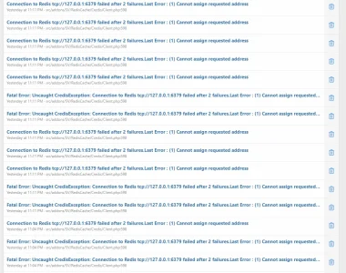

I got two this kind of errors and it happens everyday, could you please take a look, I'd much grateful
Connection to Redis failed
Server error log
CredisException: Connection to Redis tcp://127.0.0.1:6379 failed after 2 failures.Last Error : (1) Cannot assign requested address src/addons/SV/RedisCache/Credis/Client.php:598
Generated by: Unknown account Jan 10, 2023 at 11:11 PM
Stack trace
#0 src/addons/SV/RedisCache/Credis/Client.php(594): Credis_Client->connect()
#1 src/addons/SV/RedisCache/Credis/Client.php(946): Credis_Client->connect()
#2 src/addons/SV/RedisCache/Redis.php(409): Credis_Client->__call('mget', Array)
#3 src/addons/SV/RedisCache/Redis.php(49): SV\RedisCache\Redis->SV\RedisCache\{closure}()
#4 src/addons/SV/RedisCache/Redis.php(436): SV\RedisCache\Redis->redisQueryForStat('gets', Object(Closure))
#5 src/addons/SV/RedisCache/CacheProvider.php(63): SV\RedisCache\Redis->doFetchMultiple(Array)
#6 src/XF/DataRegistry.php(114): SV\RedisCache\CacheProvider->fetchMultiple(Array)
#7 src/XF/DataRegistry.php(82): XF\DataRegistry->readFromCache(Array, Array)
#8 src/XF/DataRegistry.php(226): XF\DataRegistry->get(Array)
#9 src/XF/App.php(1650): XF\DataRegistry->offsetGet('codeEventListen...')
#10 src/XF/Container.php(28): XF\App->XF\{closure}(Object(XF\Container))
#11 src/XF/App.php(1450): XF\Container->offsetGet('extension.liste...')
#12 src/XF/Container.php(28): XF\App->XF\{closure}(Object(XF\Container))
#13 src/XF/App.php(2640): XF\Container->offsetGet('extension')
#14 src/XF/App.php(2668): XF\App->extension()
#15 src/XF/App.php(1330): XF\App->extendClass('XF\\AddOn\\Manage...')
#16 src/XF/Container.php(28): XF\App->XF\{closure}(Object(XF\Container))
#17 src/XF/App.php(2163): XF\Container->offsetGet('addon.manager')
#18 src/XF/App.php(1749): XF\App->setupAddOnComposerAutoload()
#19 src/XF/Pub/App.php(89): XF\App->setup(Array)
#20 src/XF.php(364): XF\Pub\App->setup(Array)
#21 src/XF.php(387): XF::setupApp('XF\\Pub\\App')
#22 index.php(20): XF::runApp('XF\\Pub\\App')
#23 {main}
Fatal Error
Server error log
ErrorException: Fatal Error: Uncaught CredisException: Connection to Redis tcp://127.0.0.1:6379 failed after 2 failures.Last Error : (1) Cannot assign requested address in
/home/domain.com/public_html/src/addons/SV/RedisCache/Credis/Client.php:598 Stack trace: #0
 /home/domain.com/html/src/addons/SV/RedisCache/Credis/Client.php(594): Credis_Client->connect() #1
 /home/domain.com/html/src/addons/SV/RedisCache/Credis/Client.php(946): Credis_Client->connect() #2
 /home/domain.com/html/src/addons/SV/RedisCache/Redis.php(409): Credis_Client->__call('mget', Array) #3
 /home/domain.com/html/src/addons/SV/RedisCache/Redis.php(49): SV\RedisCache\Redis->SV\RedisCache\{closure}() #4
 /home/domain.com/html/src/addons/SV/RedisCache/Redis.php(436): SV\RedisCache\Redis->redisQueryForStat('gets', Object(Closure)) #5
 /home/domain.com/html/src/addons/SV/RedisCache/CacheProvider.php(63): SV\RedisCache\Redis->doFetchMultiple(Array) #6
 /home/domain.com/html/src/XF/DataRegistry.php(114): SV\RedisCache\CacheProvider- src/addons/SV/RedisCache/Credis/Client.php:598
Stack trace
#0 [internal function]: XF::handleFatalError()
#1 {main}
My config.php setup with redis
// setup redis caching
$config['cache']['sessions'] = true;
$config['cache']['enabled'] = true;
$config['cache']['provider'] = 'SV\RedisCache\Redis';
$config['cache']['config'] = [
    'server' => '127.0.0.1',
    'port' => 6379,
