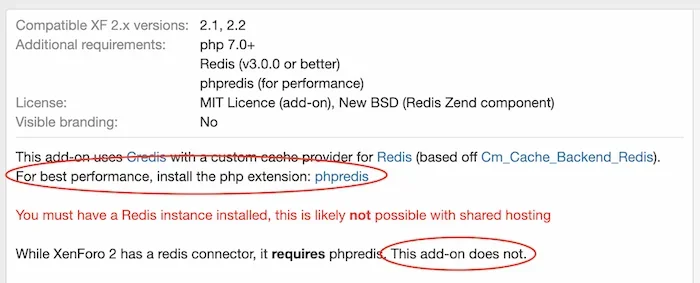

Apologies if this was asked previously (this thread is 25 pages long)...but I find the Add-on description a bit confusing.
The way I read the description...it says the phpredis extension is needed...and it says the phpredis extension is not needed:
  • The first circled area says..."For best performance, install the php extension: phpredis".
  • The 2nd circled area says phpredis not needed.
I know technically the first circled area says "for best performance". But hey...don't we all want the best performance.:)
1. Can someone clarify please if phpredis extension is needed or not. Or does installing the phpredis extension make this add-on better (but not required)?
2. If someone is experienced with this add-on (and has phpredis extension installed)...any estimates on how much faster/better this add-on is with phpredis extension installed?
3. Will this add-on work with a VPS?
Thanks Much.:)
This add-on does not require the phpredis extension, and I don't have any real solid performance benchmarks for modern php. I largely still use it because it allows more flexible deployment in my development enviroment.
