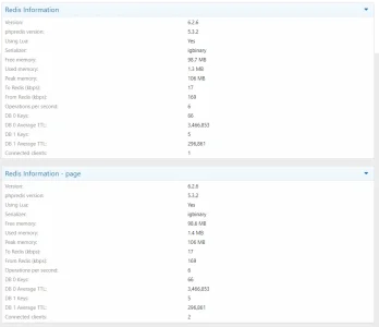

After this update, it shows the Redis stats twice. Is this expected to happen?
The add-on now extends all cache handlers which use the stock Redis connector, so it is discovering the page cache handler and shimming it too.
The problem is the stats display doesn't realize these are identical redis backends.

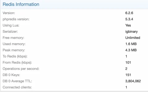

I guess this is where I get confused. This is that section:
So, what you are saying is that it's likely failing on the igbinary serialization and silently using php even though this shows igbinary, correct?
phpredis extension will pull in the igbinary serializer as a dependency so it is likely just working correctly.
Thanks.
So, just to confirm, igbinary not listed as a serializer here is not an issue? I know you addressed this but I assumed this was confirmation it wasn't installed. I also do not see it in my phpinfo().
