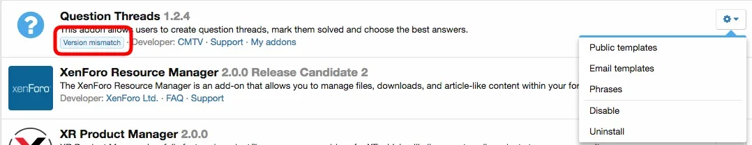

Trying to upgrade from version 1.2.4.
Removed the three folders.
Uploaded the new files
Refreshed the addon page in /admin.php
Receive the statement version mismatch
There is no option to rebuild in the pull down or to upgrade
Do you have any suggestions?
