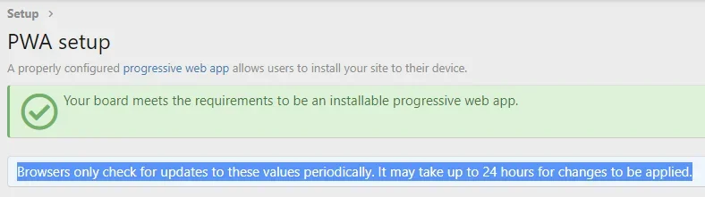

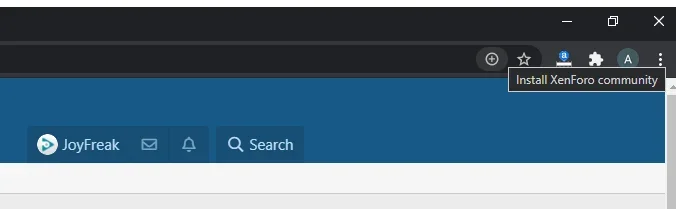

So I've set up the PWA and my board meets all requirements. However, I don't see the install button on my browser for my site as seen on here. Does it take a while for it to show up or something? I just want to make sure I've set up it correctly and it works as intended.
Did this ever end up working for you? I set mine up yesterday and still nothing, tried clearing my cache and using different (supported) browsers from different computers/mobile devices. My PWA setup says everything meets requirements and is successful (green).

Yes, it can take some time for the browser to refresh the manifest.
Try a hard refresh.
Edit: It shows for me so it's just a browser issue for you.
That's nice to hear, thanks for checking! I did try a hard refresh but it still didn't show up and I also tried it in another browser, i.e Microsoft Edge but still nothing. I'll just have to wait this one out until my browsers do their thing :).
