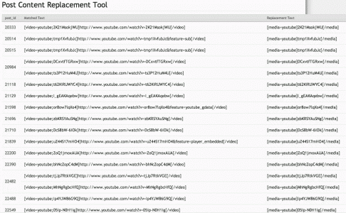

Most likely, I haven't tested but you can probably use:
#\[video\=(youtube|youtube_share)\;([a-z0-9-_]+)\][^\[]+\[\/video\]#siu
[video=youtube;g0uAlX9RSEI]http://www.youtube.com/watch?v=g0uAlX9RSEI[/video]
[video=youtube_share;gQV8yReZQY8]http://youtu.be/gQV8yReZQY8[/video]
Quick Find:
[video
Regular expression:
#\[video=(?:youtube(?:_share)?);([^]]+)[^\[]+\[/video]#siu
Replacement String:
[media=youtube]\1[/media]

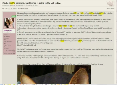

Quick Find:
â
Regular expression:
#‘|’#siu
Replacement String:
________________________________________

I get a white screen with this error. JUST with the first one you gave me (â), the second seems to find the codes on the test mode.
Fatal error: Out of memory (allocated 234881024) (tried to allocate 32 bytes) in /home1/admin/public_html/community/library/Zend/Db/Statement/Mysqli.php on line 294
can i change the quick find to this †? i get a lot of them this way.
The problem with that is while it would catch †, it would also match strings that start with that and mess them up.
â€
â€
â€
The only easy way to replace †is to replace all other strings containing †first or you will end up with all sorts of weirdness.
Example:
“ -should be- “ but running the replacement for †anything but last would leave you with this ”œ making many steps needed to fix this.
to be honest in this case I am not comfortable just giving you instructions because you can really mess up your post table if you do anything out of order or incorrectly,it wont completely ruin your posts but it will make it 50 times harder to replace everything and at the very least take a lot of time.
If this addon supported using a callback processor I could write a script to handle this with one shot but with regex alone it is very involved and probably not suitable for someone who doesn't already understand it and I don't want to be responsible if your posts get fubar'd and I don't have the time at the moment to do anything that will take a lot time researching.
