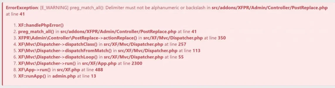

I am running XF v2.2.2
I want to replace old imported youtube links [URL]https://www.youtube.com/watch?v=u9Dg-g7t2l4[/URL]
Quick Find: [URL]https://www.youtube.com/watch?v=
Regular expression: \[URL\]https:\/\/www.youtube.com\/watch\?v=([\w\-]+?)\[\/URL]
Replacement string: [MEDIA=youtube]$1[/MEDIA]
I receive this error:
Any help would be greatly appreciated.
Thank you!

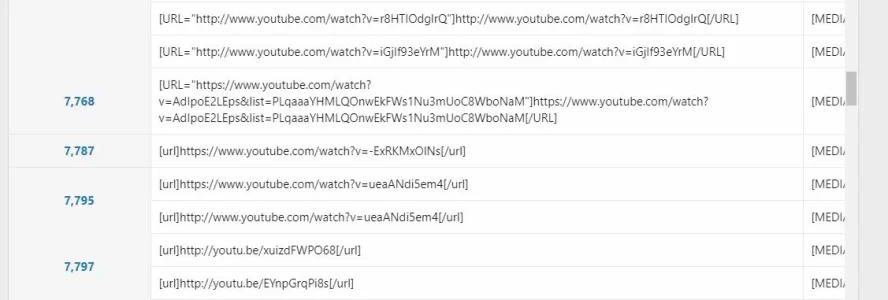

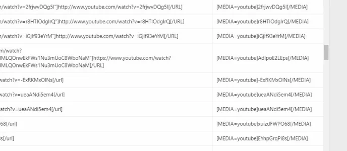

Okay, I think I found the ultimate solution for anyone with [URL] youtube.com [/URL] and [URL] youtu.be [/URL] links....
It comes from this post : Replace URL Youtube Links
And the summary is:
Quick Find:
[url
Regular expression:
#(\[url(?:]|[^]]+]))http(?:s)?://(?:www\.)?(?:[a-z0-9-]+\.)?youtu(?:be\.com/(?:[a-z]+(?:/api/videos/)?)|\.be)(?:\?v=|/)?([a-z0-9_-]{11})(?:[^\s[]+)?(\[/url])#siu
Replacement String:
[MEDIA=youtube]\2[/MEDIA]
The result is pretty awesome.
Nice, this one found 63 that I had not found with all my various iterations after a manual conversion of my local forum when I converted from DNN (DotNetNuke) back in April 2015. Thanks!!!
