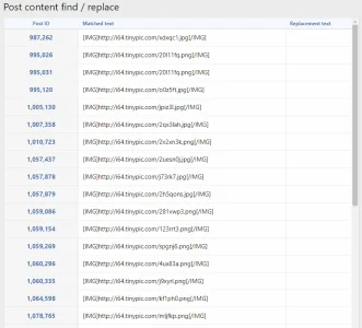

alright. so i kept replacement field empty. and this was the result without save option.
this seems accurate right? this would basically replace this bbcode with nothing? addon is indeed working and this code would help a lot! thanks.

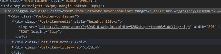

i have tested some of the oldest images and all of them work with webp. i mean they are being generated on the fly for display on their frontend on compatible browsers. i have seen their homepage load webp while the actual image pages load the regular version.
it is a safe gamble in any case because i can rename the files back to jpegs and they would load just fine. (all images work with jpg/gif/png/webp extensions on imgur!)

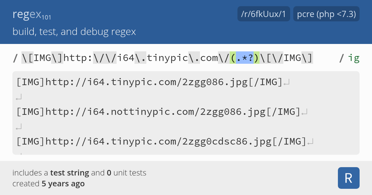

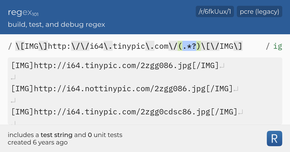

Use this to test it
It lets you do a live regex replace. So you can try the regex. See if all the images seem to work. Before you commit to a database change.

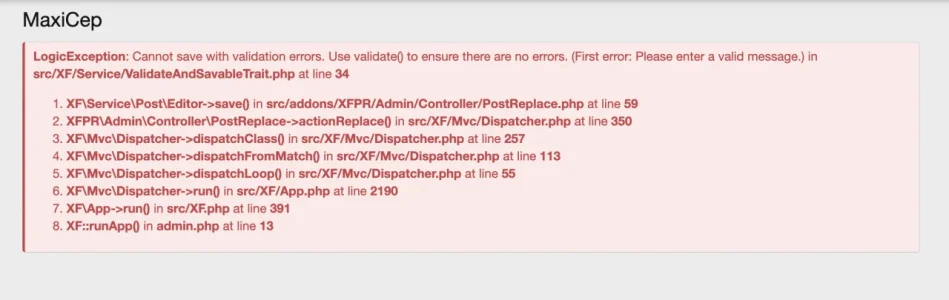

Results are right on test mode, but after i click the "save changes" mode, it gives error on xenforo 2.1.10
So plugin doesn't work with 2.1.10 anymore ?
