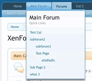

Here is one option:
http://xenforo.com/community/threads/nodes-as-tabs-with-tab-selection.23295/page-6#post-293965
It's a small file and template modification for this addon which enables depth to the child nodes. It looks like this:
