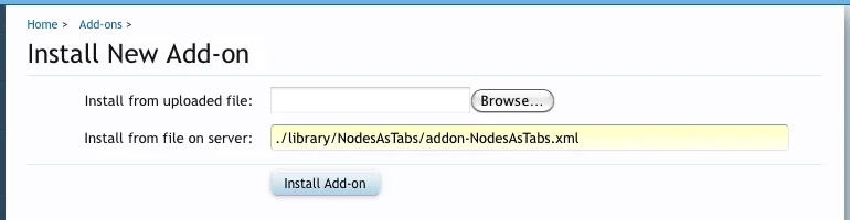

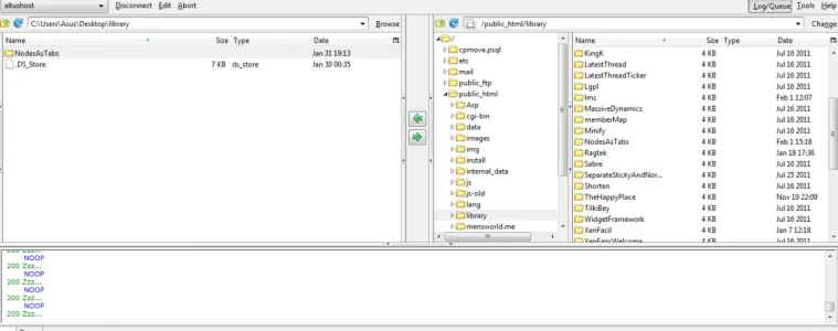

Hm, i cant install this Addon: "Das mit dem Add-On verbundenen Dateien konnte nicht gefunden werden. Bitte lade diese Datei auf deinen Server und versuche es noch einmal." Which means: Some Files are missing, and i should upload it to the Server. BUT, i have uploaded all Files to the library.
Maybe you uploaded the files to the wrong location. You should end up with a NodesAsTabs folder inside of library.

Try installing the .xml file from the server, if you already tried from your computer.
Or the other way around.
