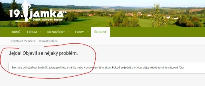

i need turned off "Profile posts". When i set no in group permision - ok, functions disappear everywhere except title "New profile posts" in page "Whats new". Can you help me?

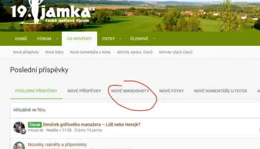

Can you screenshot which link you're referring to? There are two possibilities.
That said, both are attached to checking the canViewProfilePosts() method, so that likely means that profile post viewing is still set for at least this user group. You should use the permission analyze tools to check this.

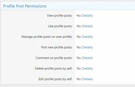

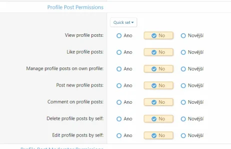

Thx for yoour reply. A use analyse tools for this users, see attach (czech language):
"Co nového?" = "Whats new?"

Can you confirm this with add-ons disabled and on the default style? I suspect that this may be related to the style, though it's possible it may be caused by an add-on.
Problem solved, you're right.
Problem is only template UI.X 2, i will contact them. Im sorry and thank you.
