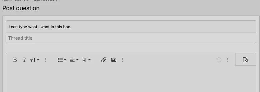

Is it possible to prevent text being typed in the prefix box?
To remove any confusion where people might type the title in the wrong box?
The choices.js library doesn't quite have that as an option. For some reason it force enables search-as-you-type for multiple mode which multi-prefix uses. The previous select2 multi-prefix system had a similar issue.
Would you be interested in funding that sort of change?
ie people like me. This caught me out this morning: I just typed the title in what now appeared to be a normal title text field, but then got kept getting an error when trying to post.

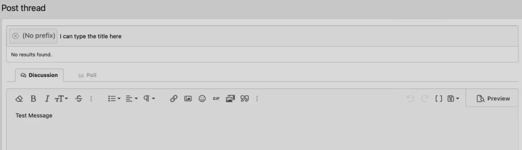

The thing is the thread title prompt as shown in matt's example above, is not there if you type the title in after the message:
EDIT: If you think about it, people are used to just typing the title to the right of the prefix.
When I saw "no results found" in the text filed below I just assumed that was was maybe to do with similar threads, in fact, as Xon mentioned, it is searching for a relevant prefix so I was confused about why I couldn't post (kept getting an error)
I don't remember it being like that before but probably that's just me getting old. Granted I hadn't yet had my second cup of coffee.
Both v2.14.x (choices.js) and v2.13.x (select2) work the same for the input behavior. Both show "(no prefix)" and allow arbitrary text entry, and show 'no results found" for no matches.
The biggest difference is v2.14.x is initialized well before the rest of the editor is ready to accept input, and shows a prefixes... placeholder.
