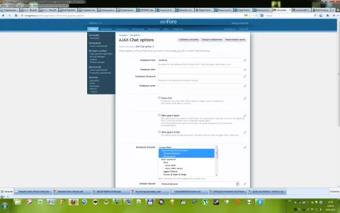

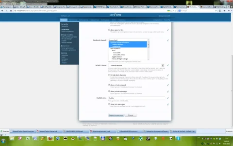

BTW, if you want me to look into your issues, I'll need your config.php file and a screenshot of your AdminCP Ajax-chat options (do not forget to mask your db credentials).
Thanks resonansER. I see you enabled the socket server. Did you follow all the steps in the readme page? /chat/readme.html#socket ?

Also, I see there is no database info on your screenshot. Did you juste erase it or is it the real state of your options?
:cool: Of Course I delete all private data.

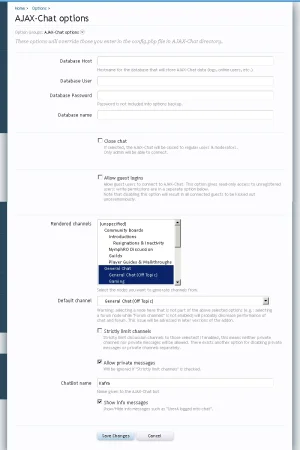

Alright, I've tried resolving it myself, just can't seem to work it out.
(Error from install file: Query: DROP TABLE IF EXISTS ajax_chat_online; Error-Report: Error-Code:)
I've attached a screenshot of my 'Options'.
I removed the Host/User/Password/DBName.
Note: I'm connecting to a separate database using the LAN IP for the database server.
My forum is configured in this manner, so I wouldn't imagine that's the issue.
(Also, I manually added the SQL tables to my secondary database that I'd like to run the chat off from).

Thanks. The XenPorta add-on will not show if you do not set the "view chat content" permissions in AdminCP > Users > User groups permissions. Did you try accessing yourdomain.com/chat/ ? Does this show any error message?
If it does not work, I would recommend to drop the tables, re-upload the files, and redo the install steps. I've seen this error reported elsewhere for AJAX-Chat MyBB installs, whithout a clue about the way (if one) to fix it. :/
