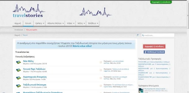

Your page never finishes loading when I try accessing it, and there are a lot of 404 errors
I'd not be surprised if you are having disk IO issues causing a load in the 70's, which is usually another VPS on the same node as you using all the IO.
Thanks for your replies everyone I really appreciate them, can you please tell me if you see a 728x90 banner on the top right? Because what I see there is a "repetition" of the site's homepage!!
The duplication is your 404 page. Inspecting the element shows a class of error404 body-class on the element.
It also appears as if you have debug mode running, you may want to turn that off for a boost in performance.

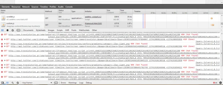

Ok thanks that's the adserver behaving weird, that's why the page never finished loading. I'm deactivating all ad codes now...
Ok it looks like the speed of the site has improved immediately after I closed the ad server code.
And I see the load dropped from 70 to 5 :)
The ad server code was requesting something that wasn't there (from the 404 error I see a request to a folder that doesn't exist), perhaps this was the problem.
