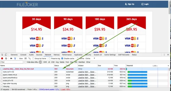

@AddonsLab filejoker.net URL are show not valid. I have posted in your demo board and you can check.
The URL you have posted returns 404 Not found response. Please see the screenshot attached.
If you notice some unusual status regarding some particular domain, it is less likely to be a bug in the product (as the product is not written specifically for any domain, any working link should work). We just depend on status code returned from the remote server.
Thank you!
@Nirjonadda , I see what is the issue. The link is shown as valid as 403 Forbidden error means the remote site may require authentication, so that does not make the link invalid. We will modify the application now not to show the redirect error for 403 links. Will check the issue with permission reported as well.

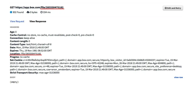

Regarding box.com URLs. We have checked this deeply, and see, that there is no bug in the product, and there is nothing we can do to make the automatic check to work with this website, as it seems to have some protection system against automatic check (not only via our product, or via PHP, but any automatic check).
You can check sending an automatic request at https://www.hurl.it/ Here is a screenshot showing the response:
The "Location" header you see tells the checker to go to that URL instead of the current one (so-called header redirect). And as you can see, the redirect URL is exactly the same as the request URL, which makes the request to be repeated, and after 4 retries it fails.
For now, the only solution is to whitelist box.com URLs not skip their check. We will continue working on it once we find some more time to try to understand what we could do to avoid this (it seems we might need to store and send some cookies to this server, but it is not clear which cookies are specifically needed for this site).
