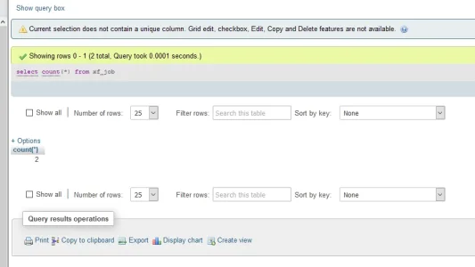

@Nirjonadda ,
Could you please check the number of records in your xf_job table:
SQL:
select count(*) from xf_job
If you have more than 50 records, we will need to investigate what is the full content of the table. Please send us the backup of table content via a ticket so we can check it in details.
Thank you!

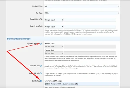

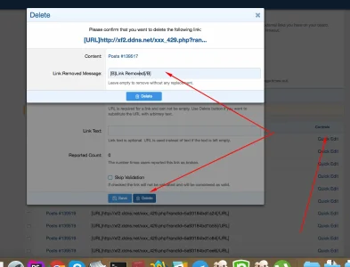

@Nirjonadda ,
Please check the latest release for performance optimizations.
Regarding quick edit, delete and leaving custom message all works for us. Please see the screenshots that should explain how we considered this should work.
Regarding the default selected, yes, now it is Delete Tag instead of being Replace. For now, we can not change this, maybe will find a way to implement the fix. So, when you select URL as type, the default option is still Delete Tag. Just change it to "Update URL/Text" and enter the details you need for the replacement. It seems what you mean as problem is that you switch to "Update URL/Text" but you still see the Delete Tag custom message. Don't worry, the tags will not be deleted, that field is visible, but is not editable.
I hope this clarifies all.
Thank you!
