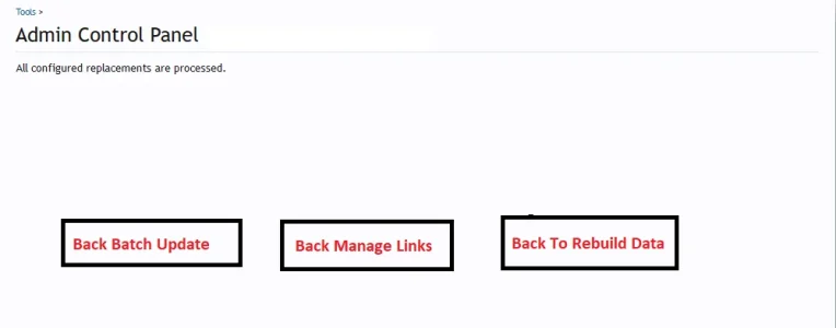

@AddonsLab One more improvement request for Batch Update. Adding Back To Button.

Great, Please can add message with URL count?
Example: All configured replacements are processed with X URL deleted. (When do deleted) or Replaced (When do Replace)
