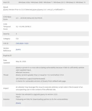

Hopefully this offers another new perspective. Moving forward, I hope you will consider PCI compliance to prioritize updates for 3rd party vulnerabilities even if XF isn't necessarily exploitable. The forums are selling memberships and payment providers require your site/server is PCI compliant or the merchant is subject to penalties and other liabilities. Thanks for your swift reply! You guys operate with excellence!

We are required to enter our website or server IP address. The scan is then performed for PCI compliance. You either pass or fail. They don't care about anything else. This particular vulnerability has existed since April 2019. I see no benefit in using a Jquery that has a known security issue in it for over 10 months and apparently was your intention to go over 12 months using it. Thanks for your consideration.

Any updates @Mike ? We are failing PCI compliance per the JQuery issue. I understand what you are saying, but the bank doesn't care, they want a passing report. Thanks for your consideration.

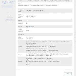

If it's significant to your particular situation, I would recommend manually replacing the referenced jQuery file with the latest version. The URL would still say 3.4.1 but the contents would differ. Note that 3.5.0 was a totally broken release so you'd have to use 3.5.1.
Note that there may potentially be some side effects due to the backwards compatibility issues the change creates.

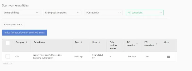

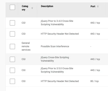

Any update from your solution to pass the PCI scan?
I gotta to do mine today and it got 6 errors, 3 of them are related to jquery 3.3.1 detected. I need to find out where they are and replace or update them.
I hate doing this and it seems the merchant account company wants you to do this every 3 months or they will penalize you.

@Andy.N
Backup your /js/vendor/jquery/jquery-3.4.1.min.js file.
Download the compressed, production jQuery 3.5.1
Overwrite /js/vendor/jquery/jquery-3.4.1.min.js with the jquery-3.5.1.min.js file.
Run your scan.
I'm not getting any errors yet on the forum by running jquery-3.5.1.min.js in place of jquery-3.4.1.min.js however as @Mike says, it may have some conflicts so reverting back after you pass may be a good idea until XF incorporates it officially.
