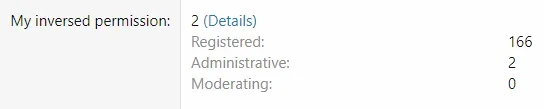

Inverse priority on "Analyze permissions" page
In order to show the lowest permission value on "Analyze permissions" page, which is oftenly used to debug permissions, you need to extend XF\Admin\Controller\Permission class:
PHP:
<?php
namespace YOUR_ADDON_ID\XF\Admin\Controller;
class Permission extends XFCP_Permission
    public function actionAnalyze()
        $view = parent::actionAnalyze();
        // Doing nothing if error happened
        if ($view instanceof \XF\Mvc\Reply\Error)
            return $view;
        // Ensure there is an analysis array
        if ($analysis = $view->getParam('analysis'))
            // Getting an array of values for different groups (+ user value for specific users)
            $intermediates = $analysis['**PERMISSION_GROUP**']['**PERMISSION_ID**']['intermediates'];
            // Getting the first value
            $lowestValue = array_shift($intermediates)->value;
            // Iterating values
            foreach ($intermediates as $intermediate)
                // A zero (0) value is equivalent to "No" and should not be counted (use "Unlimited" option instead)!
                if ($intermediate->value !== 0)
                    // If current value is lower than $lowestValue, use it
                    $lowestValue = min($lowestValue, $intermediate->value);
            // Setting final value to $lowestValue
            $analysis['**PERMISSION_GROUP**']['**PERMISSION_ID**']['final'] = $lowestValue;
            $view->setParam('analysis', $analysis);
        return $view;
Again, don't forget to replace YOUR_ADDON_ID, **PERMISSION_GROUP_ID** and **PERMISSION_ID** with desired values.
Result:
