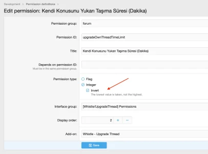

Seeing as the current implementation of the INT permission goes by the highest number, I suggest the creation of a 2nd type of INT permission for developers to use that will do the opposite and go by the lowest number.
Use case would be for any permission made for time delaying an action (in which a lower number would actually be of greater value)

It's been a recurring issue in add-ons. The core software has simply moved/placed everything that could profit from a lowest-first integer permission in options instead - minimum time between messages/threads to name just two.
It would just make sense to have it. Sure, you can work around with a more complex setup where your higher value usergroup gets replaced with a lower value usergroup, but it's unneeded and confusing overhead for people who are not as savvy in setting up permissions.
I think adding a new int permission that behaves opposite to another int permission will only add (much) confusion for most Admins, and not worth it for the few scenarios where the lowest value is needed. I would just use an option that lists user groups with a desired value below each user group that can be increased or decreased, and perform a isMemberOf via a switch statement that returns the value on the first positive hit. I've used this approach in the past with no issues.
The downside is (obviously) you would need an add-on, but then when members here want core functionality changed or a new one added, it normally takes an add-on anyway, so it's not much of a downside.
