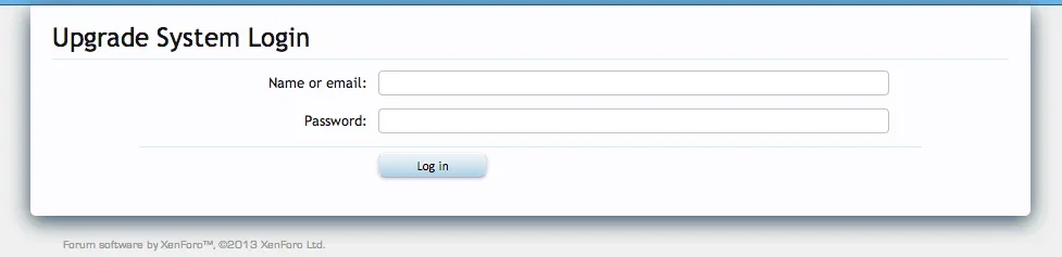

This is what the warning says:
The user name or password you entered for area “Restricted” on xenforo.com:80 was incorrect. Make sure you’re entering them correctly, and then try again.
Your password will be sent unencrypted.
As @whynot said... you don't use xenforo.com... you use YOUR domain.

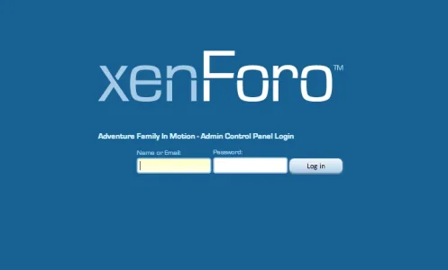

This is what I get when I go to the admin
and to your install

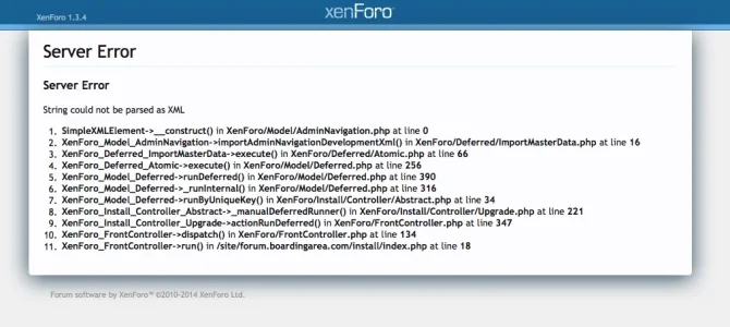

Upgrading from 1.3.3 to 1.3.4 and received the following error. I'm uploading files again and will try to run the upgrade process again. We only have a couple of add-ons installed on this site and I did leave them active. If my 2nd upgrade fails I'm going to restore the files, disable the add-ons and try again. Anybody have any other ideas, suggestions or anybody have the same issue?
Uploading the files again should resolve that.
If it doesn't download a fresh upgrade .zip and use a different FTP application.
I recommend WinSCP.
