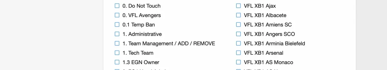

Also.. Our site has a lot of Usergroups so would it be possible to have 2 columns..
This is how the Usergroups Current appear
This is how I would like them to appear
Thanks

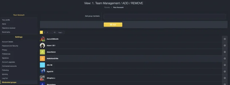

Something else I thought of.. As some of our users have multiple tags, could their tags be shown next to their username here?
