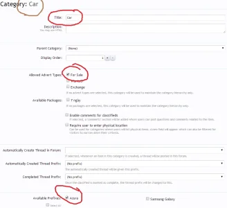

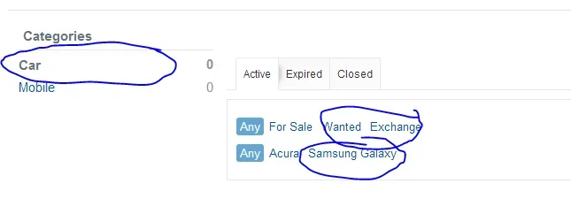

@Mr. Goodie2Shoes ,
You have guided me show menu filters
library/GFNClassifieds/ControllerPublic/Home.php Line:151
/library/GFNClassifieds/ControllerPublic/Category.php Line:173
<xen:include template="classifieds_filter_menu">
<xen:map from="$pageNavParams" to="$params" />
</xen:include>
it worked very well but there is a problem like the screenshot below ( Advert Type Filters and Prefix Filters displayed in all categories )
show menu filters
Please help me fix it,

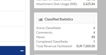

@bt012ss edit the classifieds_sidebar_block_stats template and wrap the whole div with
<xen:if is="{$canViewClassifieds}">
<!-- the whole template -->
</xen:if>

Anywho, after looking at the code if that is changed to only show advert types available for the category, there is a potential conflict with the classified lists so it's better not to modify that at this moment.
This would require a bit of custom coding and the number of queries will increase for that. This is the main reason to keep the filter menu as a separate API call for those who want to filter the listing.

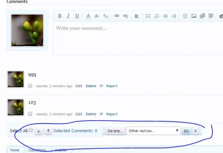

@xfstyle that layout of inline mod overlay isn't possible with default style, unless you've customized inline mod code. This add-on uses same code as inline mod tools in list of topics. It has max-width for #InlineModOverlay that makes it impossible to have such layout.
Check your customizations in inline_mod.css
