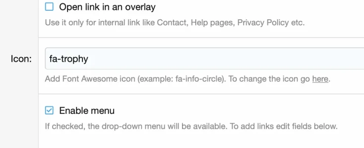

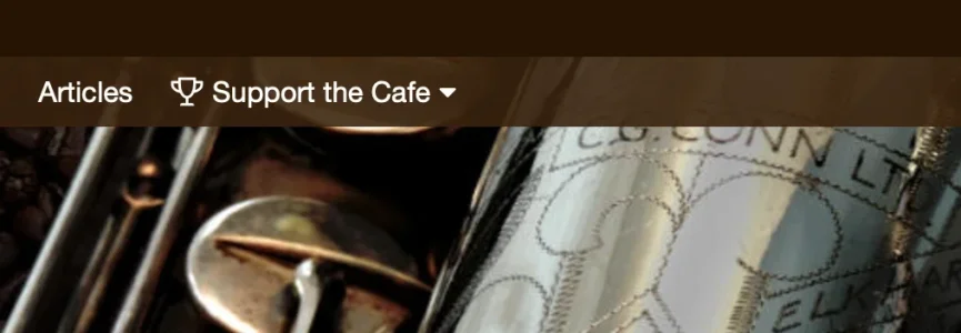

If I reference a specific icon in an addon (e.g. Top Navigation) do I need to add that icon to the list of icons in options or is it detected?
e.g. this one (fa-trophy)
Depends on how the Addon (that enables you to use FA icons in navigation, this is not a standard feature) does work:
Does it just use the entered class and do you use Solid as the font awesome weight for your style?
If so, it should be picked up automaticallyif you have added the entity field that contains the icon reference to the list of additional entities.
If either condiition is not true you would have to add the icon(s) to the appropriate icon list manually.
Version 1.3.0 (which is still a bit of work to get there) will add support for 3rd party Add-ons to add their own locations so manually adding entitiy fields can be avoided (if 3rd party Add-ons do provide the necessary data).
