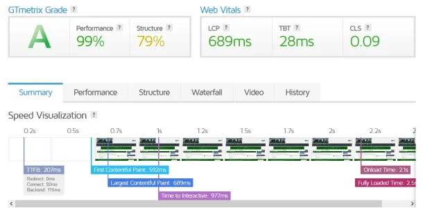

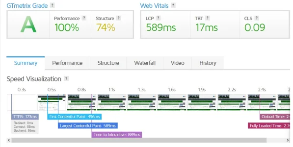

What about this? Does it take effect in UI.X 2 then? 🙄 I feel it's faster though or is it just my illusion?

Please add base url/hostname option, so that we can host the font files on CDN.
I am not sure if it would be a good idea (from a performance perspective) to just serve the fonts from a CDN, but I'll add an option for that.

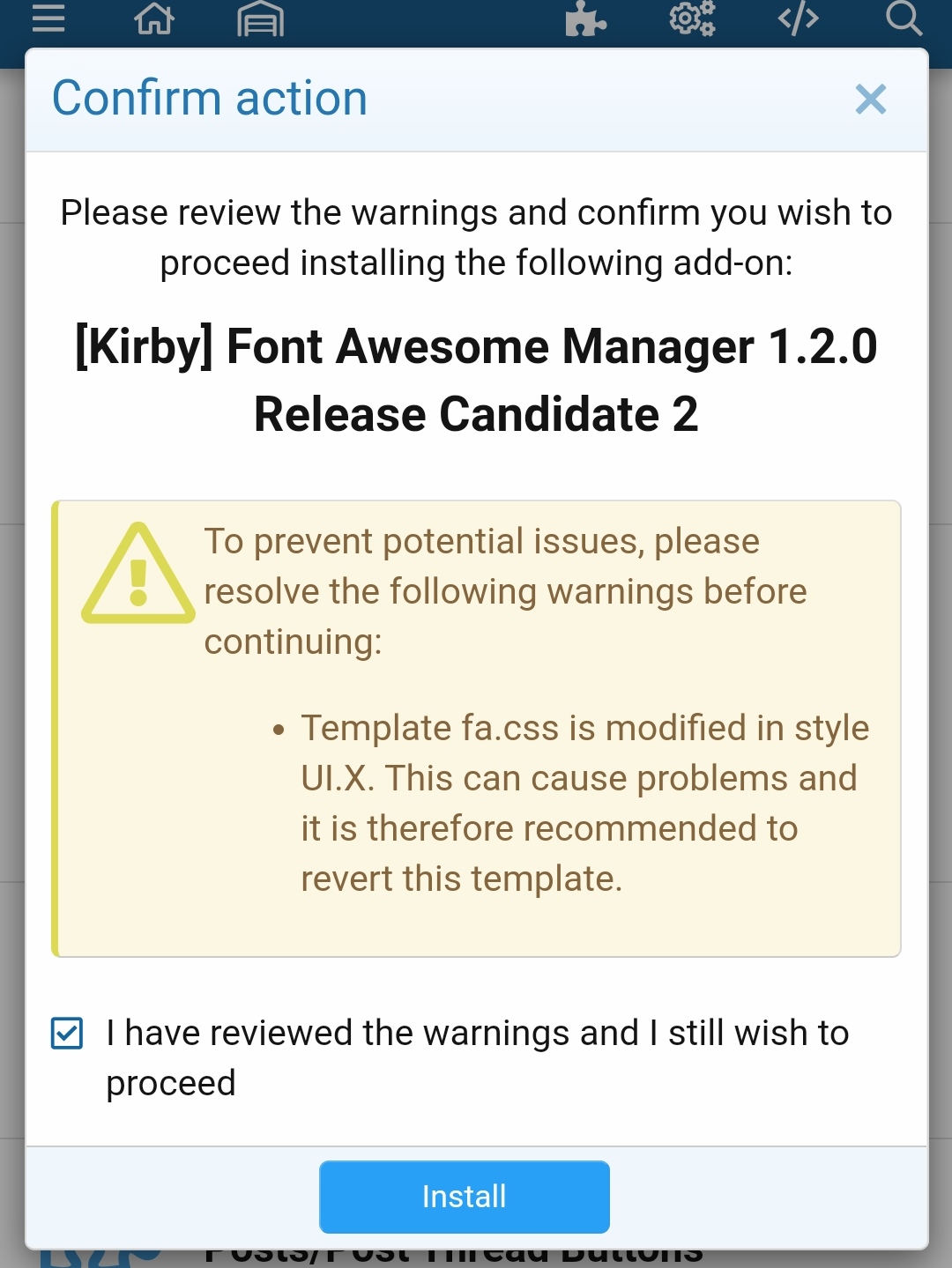

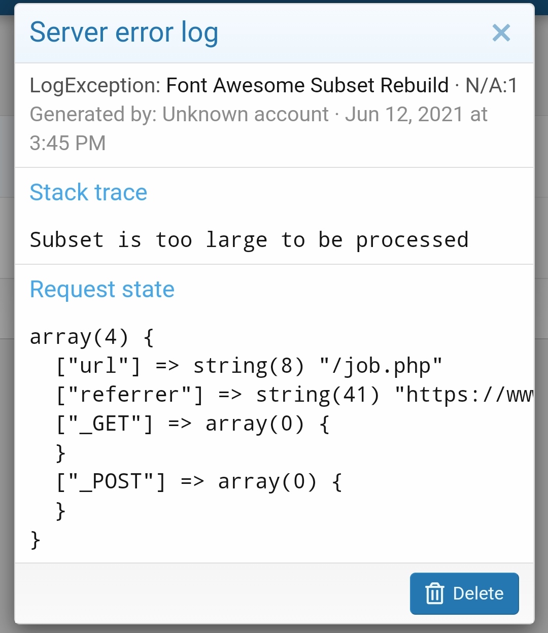

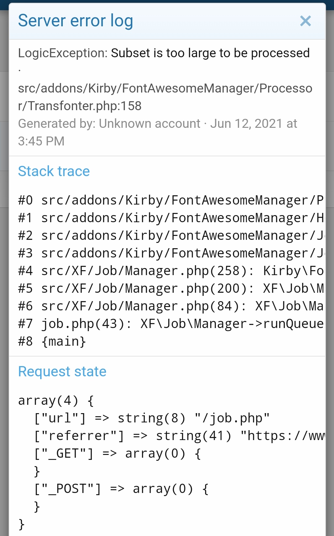

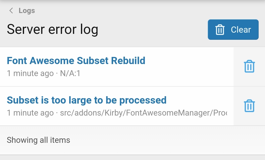

Please read the FAQ, all of those messages are explained there.
FAM completely rewrites fa.css and it is almost certain that this will not work correctly if the tamplate has been customized.
Subset too large to be processed is an error that does prevent subsets from being generated and is a clear indicator that thare is an issue with one or more of your templates.
You'll most likely have to find out which templates are causing this and ignore them.
