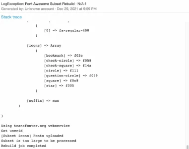

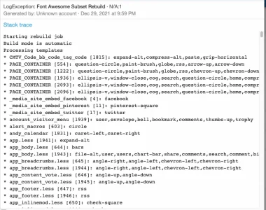

Okay, not sure this is exactly what you were looking for, but I set it to debug and found this.
(That is the top/bottom, should I paste the entire text?)

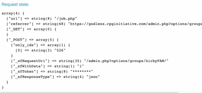

This is exactly what I was asking for, but unfortunately it us incomplete and missing the most important part.
Yes please, ideally as a text file attachment.
Please also carefully read the FAQ on error message Subset is too large to be processed and support for 3rd party Styles/Add-ons.

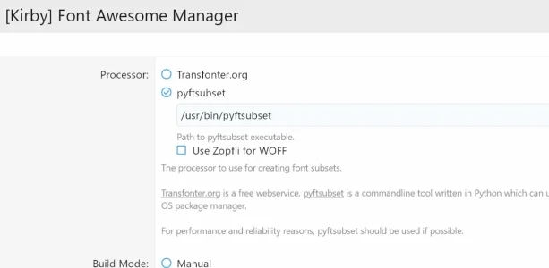

Hello Kirby!
Houston we have a problem. Just begin to show on my Error Server Log yesterday (or more?).
Check this errors, i think we need a update on this add-on:
First this:
GuzzleHttp\Exception\ClientException: Client error: `GET https://transfonter.org` resulted in a `403 Forbidden` response: <html> <head><title>403 Forbidden</title></head> <body bgcolor="white"> <center><h1>403 Forbidden</h1></center> <hr> (truncated...) src/vendor/guzzlehttp/guzzle/src/Exception/RequestException.php:113

And than, that:
LogException: Font Awesome Subset Rebuild N/A:1
 Generated by: Admin Jan 2, 2022 at 2:50 AM
Stack trace

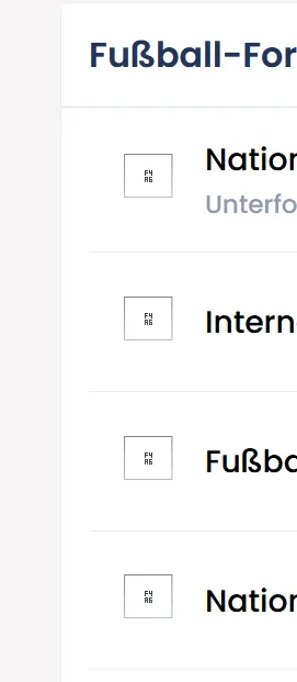

There are some styles, including Bolt from Pixelexit, where some icons are no longer displayed with FontAwesome. At least if you are still using an older version. How can I fix this quickly and easily?
Scroll down to "Troubleshooting" section and you will see this...
Troubleshooting​
Some icons are missing, how can I fix this?
This can (and depending on the Style and/or Add-ons will) happen.
Although the Add-on does try to automatically discover as many used icons as possible, it is not possible to find every icon.
If an icon is missing, it can easily be added to the appropriate list to make it available.

  2. Enable option Automatically add missing icons
  3. Visit a page that has missing icons in an fresh browsing context (private tab, other browser, completely cleared site data, etc.)
  4. Continue browsing the forums for a few minutes
    This is necessary to trigger the execution of jobs if the site does have only a low amount of traffic (or no traffic at all).
    If this is the case you can simulate traffic by just visiting many different pages to trigger job execution.
    Alternatively it is also possible to run a rebuild job manually at his point.
  5. Recheck the page from step 3)
  6. Take a screenshot of the page that has missing icons and mark the area(s) where icons are missing
  7. Disable the Add-on
  8. Revisit the page from step 3), take another screenshot and mark the area(s) where icons were missing
  9. Take a screenshot showing all settings in Font Awesome
  10. Take a screenshot showing all style properties in Font Awesome
  11. Perform a manual rebuild and save the log to a text file
  12. Start a conversation with me
    Your message must include the URL of the page from step 3), the screenshots as attachments (not embedded!) and the rebuild log.
    If you do provide multiple URLs for pages that have missing icons please include a table like this in your conversation message:
    URLFilename screenshot FAM disabledFilename screenshot FAM enabled
    If the pages are not publicly accessible please also provide login details for an account that can access them.
If you can, install pyftsubset and use it in: /admin.php?add-ons/Kirby-FontAwesomeManager/options
to avoid this problem...
  • Automatically add missing Icon
If this setting is enabled, icons missing on public pages will be added automatically.
This does work independently of build mode.
Enabling this option does increase HTML page size, JS processing time on the client and might cause frequent rebuilds.
Do not enable this option for normal production use.

In my form fields i have a lot of names, but all (not some) icons are gone now.
