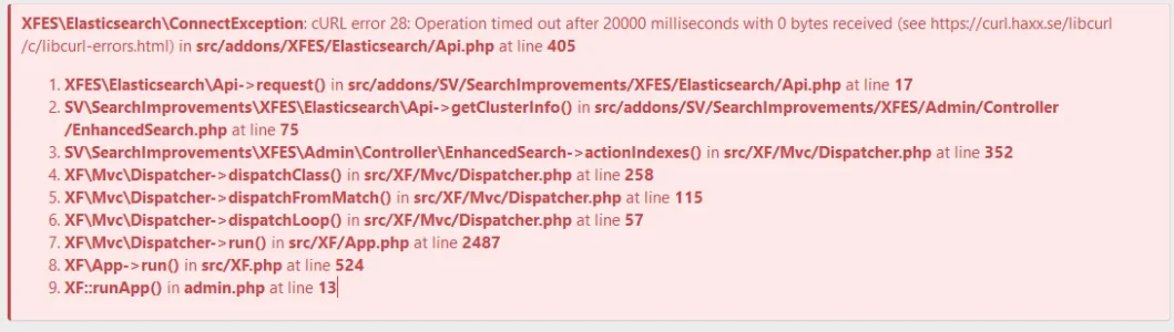

@Xon I think I have fixed with this setting but I can not Re-Configure enhanced search. Before I have used MySQL database name is Index name but now can't update Index name in Admin CP.
cluster.name: forumsearch
node.name: node-forumsearch
http.port: 9200
xpack.security.enabled: false
#http.host: 0.0.0.0
Error via /admin.php?enhanced-search/indexes
I'll investigate to see how my add-on's can be harden when elasticsearch isn't reachable.
I can enter Configure enhanced search with disabled Search Improvements addon but Add XenForo field in Admin Control Panel in field Elasticsearch Index Name then Test setting can not connection to Elasticsearch server when Elasticsearch server is still running. So for fix need disable cluster.name: in elasticsearch.yml files then Admin Control Panel in field Elasticsearch Index Name Test setting are working. Also how to fix Unassigned shards?

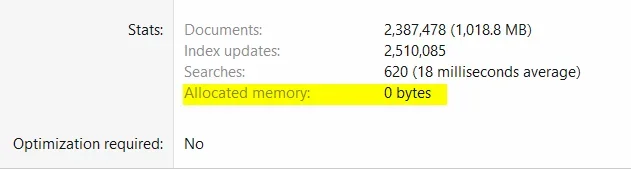

Does this OK Allocated memory is 0 bytes? When Allocated memory is used? I have setting in /etc/elasticsearch/jvm.options
-Xms512m
-Xmx512m
Updating to Search Improvements v2.10.4 will fix elasticsearch not being accessible from blocking access to the index page.
-Xms512m
-Xmx512m
Allocated memory is how much it is using for queries, this will be quite low if you don't have a any frequent queries happening that require a lot of buffering.

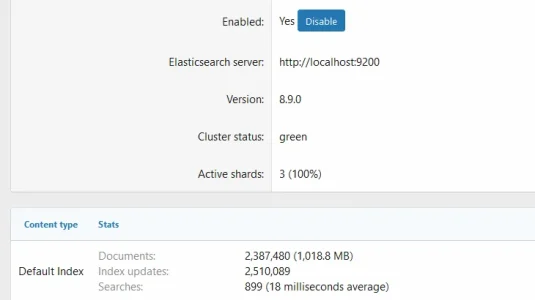

Does now OK? I see now Active shards: 3 (100%) but before Active shards: 1 (50%)
So Allocated memory is used automatically based on user Search?
yes.

Yes this is Working. So this change will be apply when make new re-index? Also Allocated memory still 0 bytes. Why not using any memory, Does have any issue for this issue?
Yes, that command adjusts new index creation. The allocated memory stuff only matters if you've got a lot of concurrent requests (or a large posting volume happening at the one time)

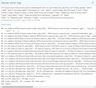

I notice that the Elasticsearch index get lost by itself after a certain time.
My envoirement:
- Elasticsearch v7.17.12 (via Docker Instance on Plesk Panel)
  • Search Improvements 2.10.4
  • ElasticSearch Essentials 3.15.8
Server error log.
My envoirement:
Server error log.
You are exposing your elasticsearch instance to the internet. This is the default configuration of docket, where it will bypass most standard firewall setups.
Don't do that.
Don't do that.
How do I solve it ?

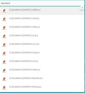

Hey guys, does anyone know which configurations I have to set so the search is more exact?
For example, I have an addon that uses XF's enhanced search but the search results are very exact (the way I want it).
However, using this awesome elastic search autocomplete addon, it returns
I tried these settings below:
