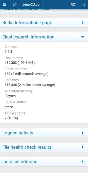

Something is not right or correct. There are so many ways to push / use ES. The latest supported ES is (I think) 8.x. ES is actually up to 9.
The latest ES is 9. Not really supported but works. My site a bit small but cranks.
