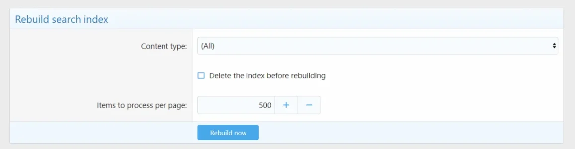

Is there any action I could try ? Like purging index maybe ?
Purging the index and re-indexing is what I'ld recommend. You can use the CLI indexer to use multiple threads which can be significantly faster than the web UI re-indexing.
It didn't help.
