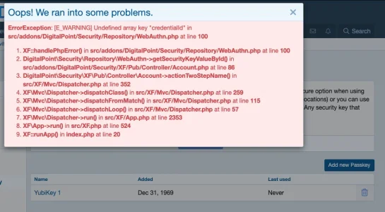

When trying to delete a hardware key, I get the following error:
ErrorException: [E_WARNING] Undefined array key "credentialId" in src/addons/DigitalPoint/Security/XF/Pub/Controller/Account.php at line 201
    XF::handlePhpError() in src/addons/DigitalPoint/Security/XF/Pub/Controller/Account.php at line 201
    DigitalPoint\Security\XF\Pub\Controller\Account->actionTwoStepDisable() in src/XF/Mvc/Dispatcher.php at line 352

Did anything going on with this account that you can think of that might be out of the ordinary? That error message implies that there's a record for a key that is incomplete somehow. Easy enough to fix, but it would be nice to get to bottom of why that incomplete record is in there before you delete it.
Do you know what type of hardware key was used to create it? It could be the hardware key itself giving a partial record for some reason, so might need to look into that.
digitalpoint updated [DigitalPoint] Security & Passkeys with a new update entry:
Adds ability to auto-extend device trust when device is actively in-use
  • Check for incomplete records when deleting a key

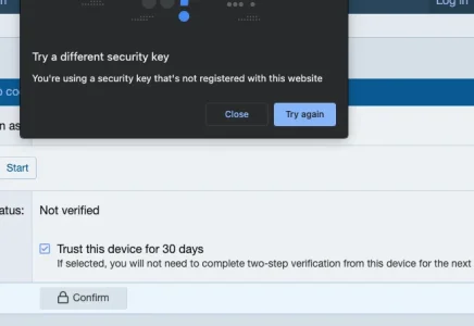

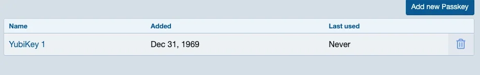

Just installed this addon for someone, and seeing something strange with it:
When I do get back in, clicking on the key throws the following error:
Do they have any other addons that add TFA options by chance? Not sure what’s going on exactly, but the info for the security key isn’t being saved for whatever reason… maybe something else is interfering with how that entity works (it’s just a theory)?
