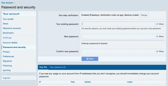

Yeah, the cog is there in the bookmarks:
Query looks OK as well with debug enabled:
and with the template modification disabled:

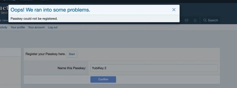

Here's an updated version that should fix the issue where an invalid Passkey gets registered/saved. If something goes wrong with the registration, the user is presented with a generic message saying, "Passkey could not be registered.", and then it logs the more technical reason why in the XenForo server error log.
This doesn't solve the "why it failed", but it should prevent an invalid Passkey from getting saved to the user TFA record and will (hopefully) give some insight as to the "why" if you look in XenForo's server error log.

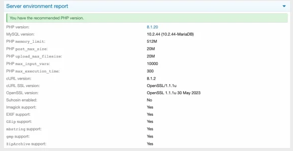

Skimming through the possible failure reasons, one thing that seems like it might be reasonably possible is if the server's root certificates are out of date. Part of the Passkey verification flow is verifying the presented root certificate is valid. So if the server has out of date OpenSSL certificates installed, it's going to fail based on it being an unknown/invalid certificate being used to sign the request from the hardware.
Thanks, getting to this point now, but nothing logged in the server error log
CentOS7.9 with Litespeed on cPanel:
Ya, if something is going on server-side (like an invalid certificate), it's going to fail with any client. Started a conversation with you so we can sort it out and not clog this thread.
