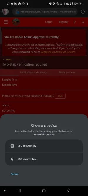

For some reason, I am on 1.1.7, and I enabled passkey support via 1password, it is not giving me an option for the passkey that I just created on my own site.
Is this a XenForo issue? A add-on issue? Or a 1password issue?
Not sure… can you disable 1password and see if it works as expected? I don’t know anything about 1password or what it’s doing.
If I turn off 1Password, it won't prompt at all. It's a software solution for Passkeys and Passwords at same time. The Passkey is connected to 1pass and won't work at all without it. Doesn't even prompt to use the passkey and I have to use the old-school method.
1password is one of the most secure password managers out there. It has never been breached in a hack attempt. It uses basically 2 or 3 passwords to add the app to a new device, then just the one master to remember.
As long as 1password supports WebAuthn/FIDO2, it should work (it’s just a standard protocol). Although I would think it needs to be supported by the browser itself rather than an app since the browser is doing the underlying “stuff”.
What browser/version are you using?
MS Edge for Android. Current build (dunno its numbers)
Everything I read says Edge on Android doesn’t yet support passkeys and 1Password sort of supports it for some things but it’s beta.
Are you able to try a different browser that definitely supports it just as a test (for example Chrome)?
There’s nothing I can do on my end to make a certain browser support passkeys faster. It’s simply a web standard that a browser either supports or it doesn’t (like you can’t make a browser support HTTP/3 magically). There is no browser specific code to make WebAuthn/FIDO2 work or change how an individual browser allows for it.
