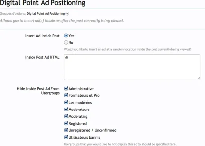

Ads showing inside the post no matter what usergroup I chose to hide them from :(
Has someone found a solution?
Sure.
I have checked-in every usergroups and I can see ad for each group :/
I have tried many combinations.
Nevertheless, it works for "ad after 1st post".
I am so sad because i love your plugin !
What do you have the "Force Inside Post Ad In Certain Forums" set to? Anything? That will override your usergroup settings.
OKKKKKKKKK
I am an idiot ! Thanks for your help.
I had every forum checked, so my usergroup settings were not taken into account.
Now it seems to work :)
