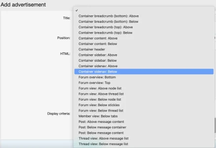

Ad position in HTML head 1.0.0
For insert code into head section in any ad position, i use xf:head
For example:
<xf:head option="abc">
code loading script (inserted into head section)
</xf:head>
code ad block script (inserted into ad position)

Yes that would work also, but requires knowledge of the XF templating language, and the head-code will be inserted under a different ad position, making it harder to find later in e.g. 1 year when you need to edit/remove/debug it :)
Also for some people just using "AdSense Auto Ads" there is no need for anything other than the head-part, so creating a different ad in another position for that is confusing and doesn't make much sense.
